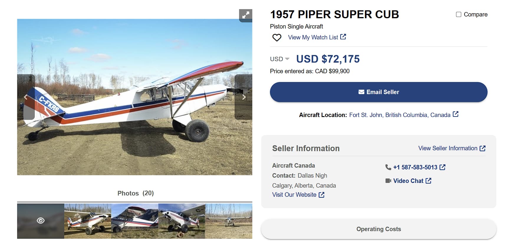

Would this be a good deal?

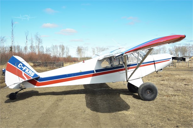

Every single part on this has a part number that can be ordered new. Engine seems Okay (more than half its life left). Gotta wait for Scott and Lee to join this chip-n-dip to get some opinions and insight into the airframe and engine values.
The best part about this plane is its Registration - C-FKRS… Sound it out.

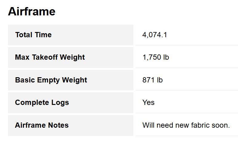

Running some rough numbers, I think I’d call this a good deal. Minor issue with it being in Canada but a DAR can help with this, it’s just an additional step and cost to the whole project. By good deal I think you’re $20-30k ahead. That’s if you do a lot of work yourself and don’t find completely rotten out tubes in the fuselage. Needs a lot of work, but may be hard to find something cheaper.

This aircraft needing new fabric soon anyway, is swapping out for a new frame that much more of a hassle knowing that all the fabric will be coming off either way? I feel like I would be tempted to put a new frame on anyway at that point just for good measure.

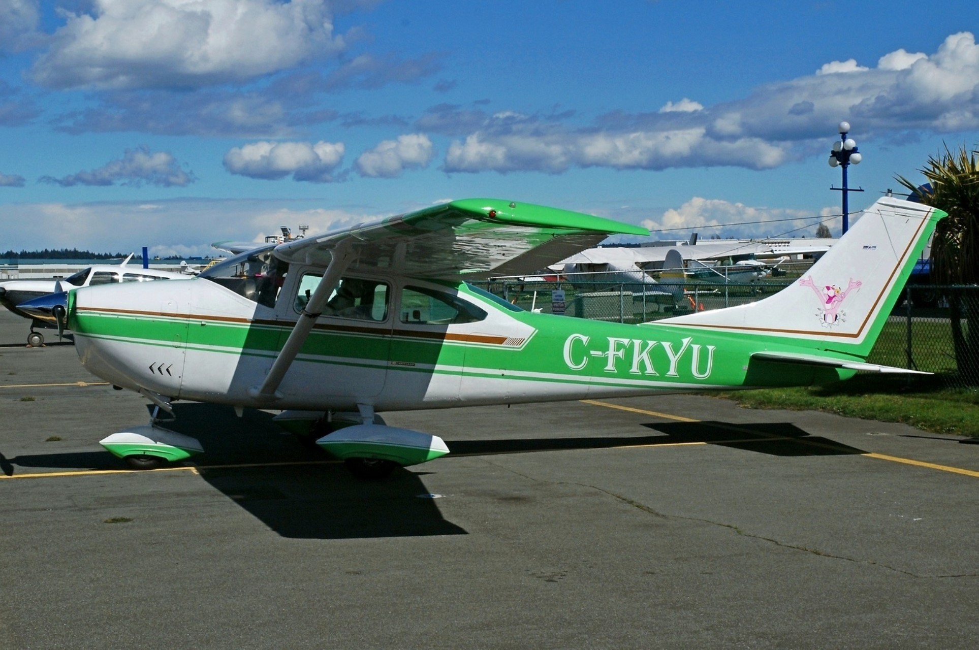

Yep! Some hilarious ones in my area. This guy pulled into an AOPA fly-in recently and definitely caught everyone’s attention.
Haha that’s even more on the nose!
