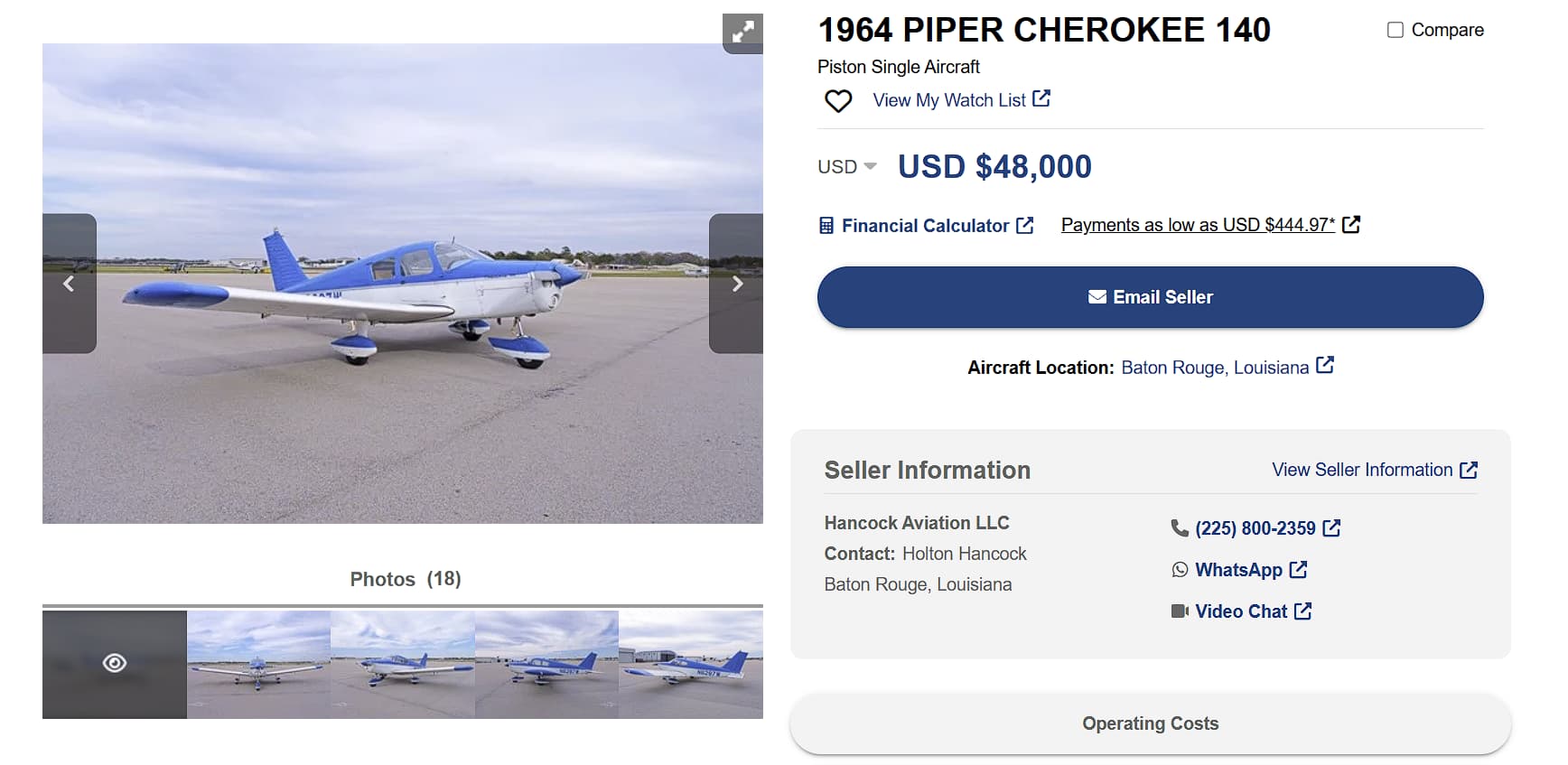

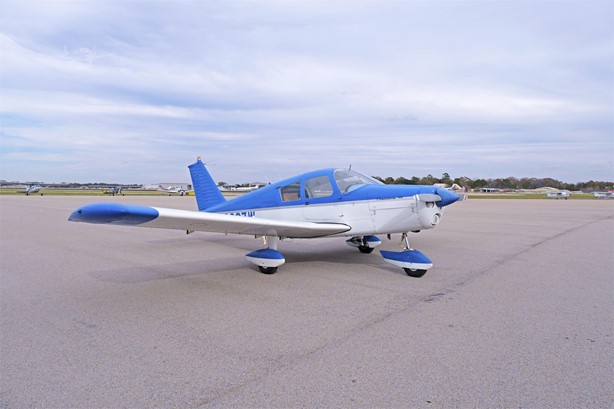

1964 PIPER CHEROKEE 140 Time Builder With A Run Out Engine
You would probably need to do an overhaul right away, but the plus side to that is you’d start with a fresh 2,000hrs before TBO! It’s even IFR certified.
I don’t know if this is a good deal or not… would need to defer to @Ben.neely @Dr.Badass & @LeeGriffing for the value of Cherokee’s!

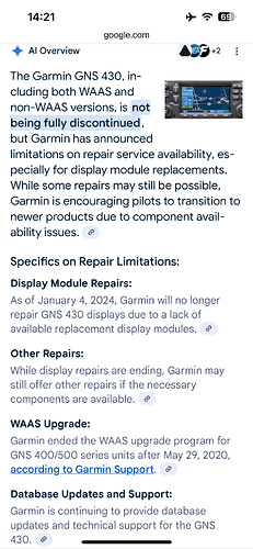

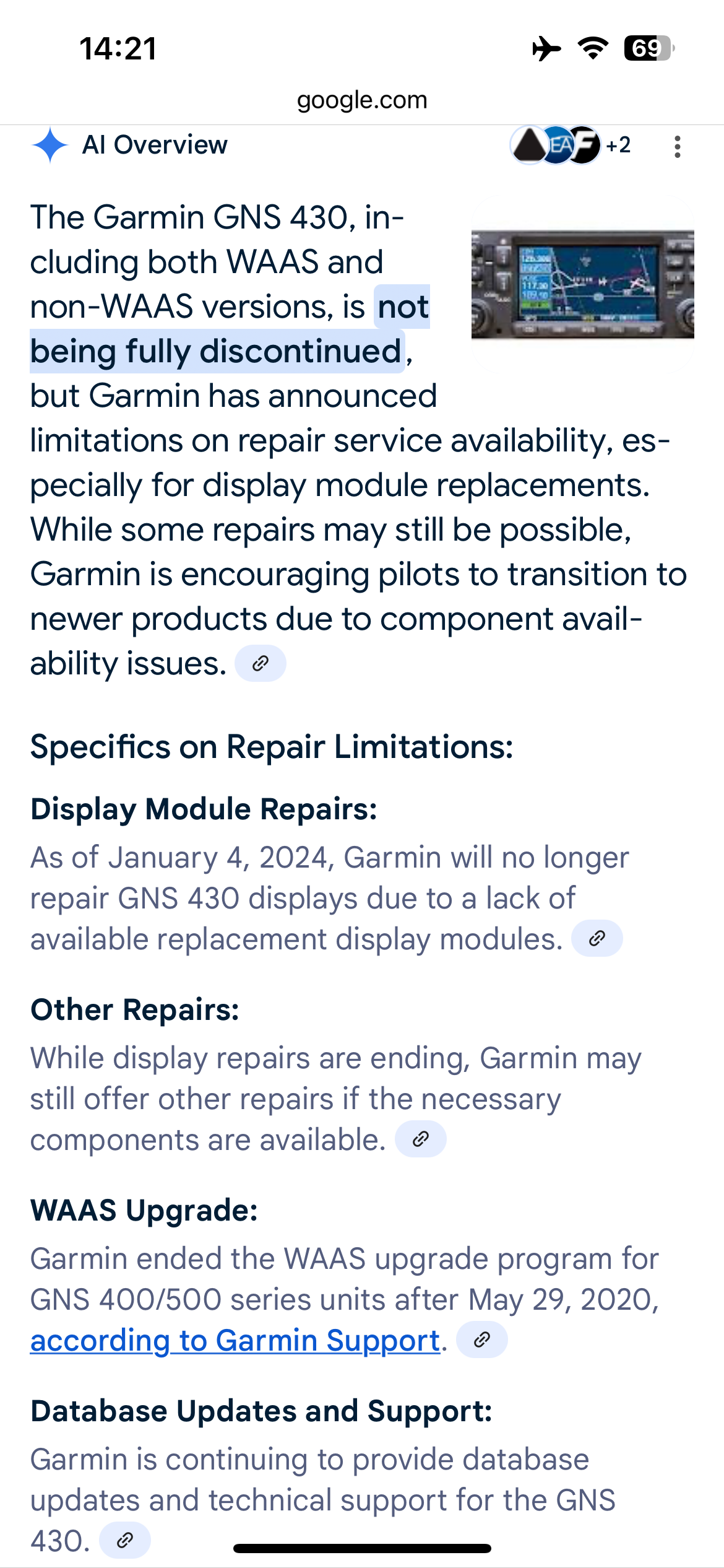

Yes, just to sort through the planes. Mentioning Avionics, I am wondering what I would want in an aircraft if I wanted it IFR certified? I know that can be as little as the six pack, but that would preclude RNAV approaches. Would a 430 be sufficient or are there other devices that do the job better?
Something to be aware of but I have liked garmin 430s
Yeah, as soon as I started to get a base line comfort level with the 430 I heard Garmin is giving it the Ax.
