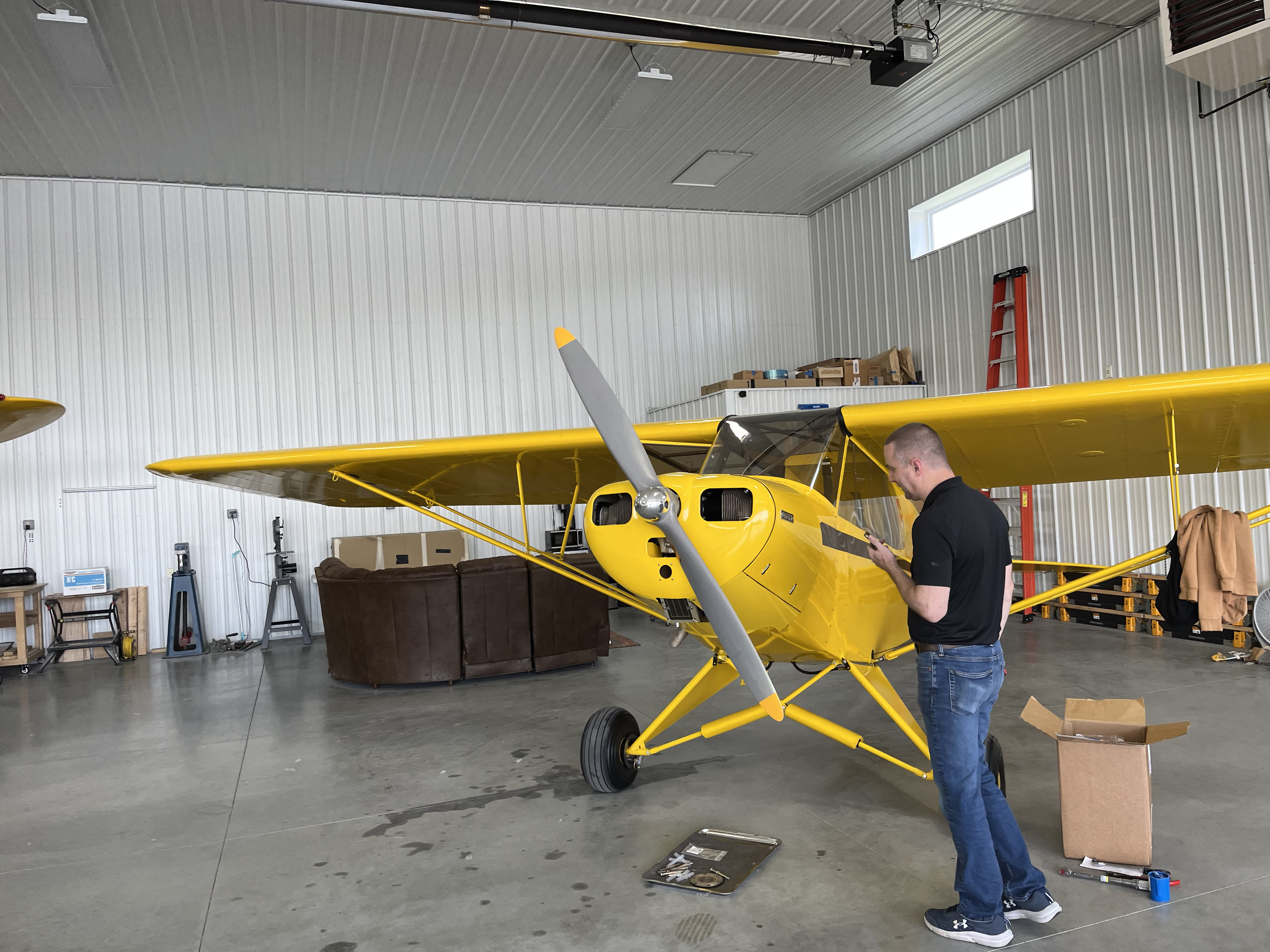

So my brother installed a 71 inch diameter 48 pitch metal propeller on the Super Cub. Coming from a 72 diameter, 50 pitch wood propeller. I only flew it once with the new metal one and it was windy so hard to tell takeoff and climb performance. I THINK it’s better. We did gain 3mph in cruise, which was not the goal but it’s kinda cool on the fixed pitch side to improve both sides of the equation when it’s usually a trade off ie: climb or cruise, not both. I don’t want maybe better, I want definitely better climb performance and airbraking on landing, so planning to pitch it down to 44.

I have access to a metal Sensenich 72 diameter 44 pitch to try. Hopefully doing that next week. I’ll have testing data to supply @IanArendt
Nice! Should be a big difference from what you had. How’d the 72/48 work?
@IanArendt the Metal McCauley 71/48 was BETTER all around than the Wood Sensenich 72/50. Gained 3mph in cruise and maybe 10% better takeoff and speed brake effect. Like adding a cold air intake to your car. Your car is faster only because you know you put it on.
Sounds like you found the unicorn. Maybe the added weight changed your angle of attack and gave you a few mph?
@IanArendt I think its the fact our prop slip went from about 6% to almost 0. Those wood props are just not efficient at all!
It would have to be an aft CG move to improve performance and I gained 21lbs right on the nose

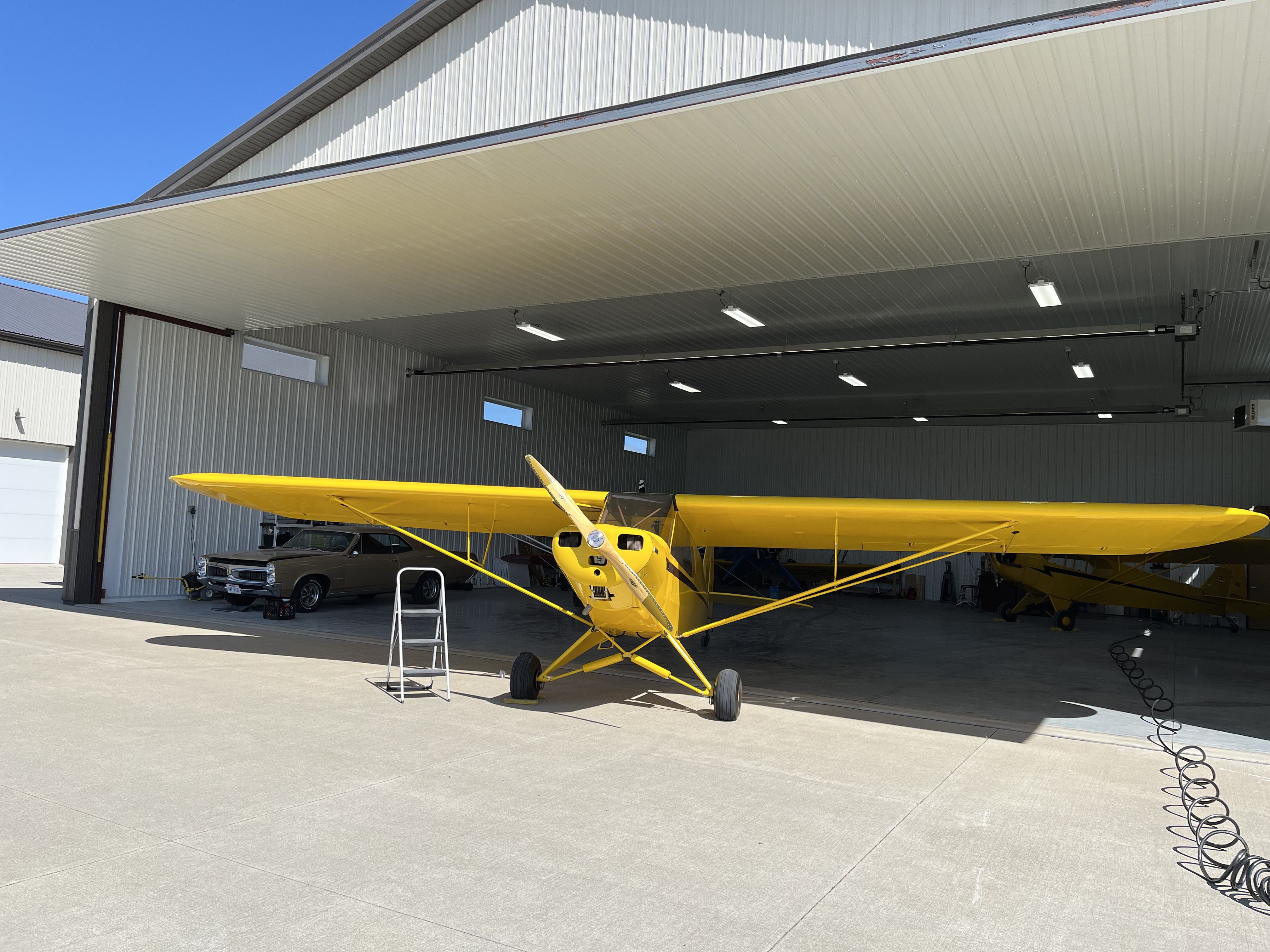

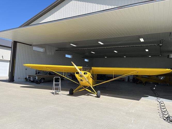

I want more climb…. Do I wait for the right metal climb prop if I can ever find one or buy the wood climb prop new from Sensenich? Not sure how much takeoff and climb performance I’d gain but I’d lose around 15mph going wooden climb. If aesthetics are a big contributor here’s a couple pics for comparison.
