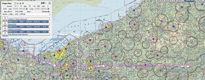

I have to make a flight from KLHV to KPCW to bring my new bird home. She only holds 18gal of fuel and burns around 5gph(But don’t know the practical burn with this particular prop and carburetor setup). I’m planning 90mph TAS and 5gph. I have No ADS-B, No radio, No transponder, No electrical system.

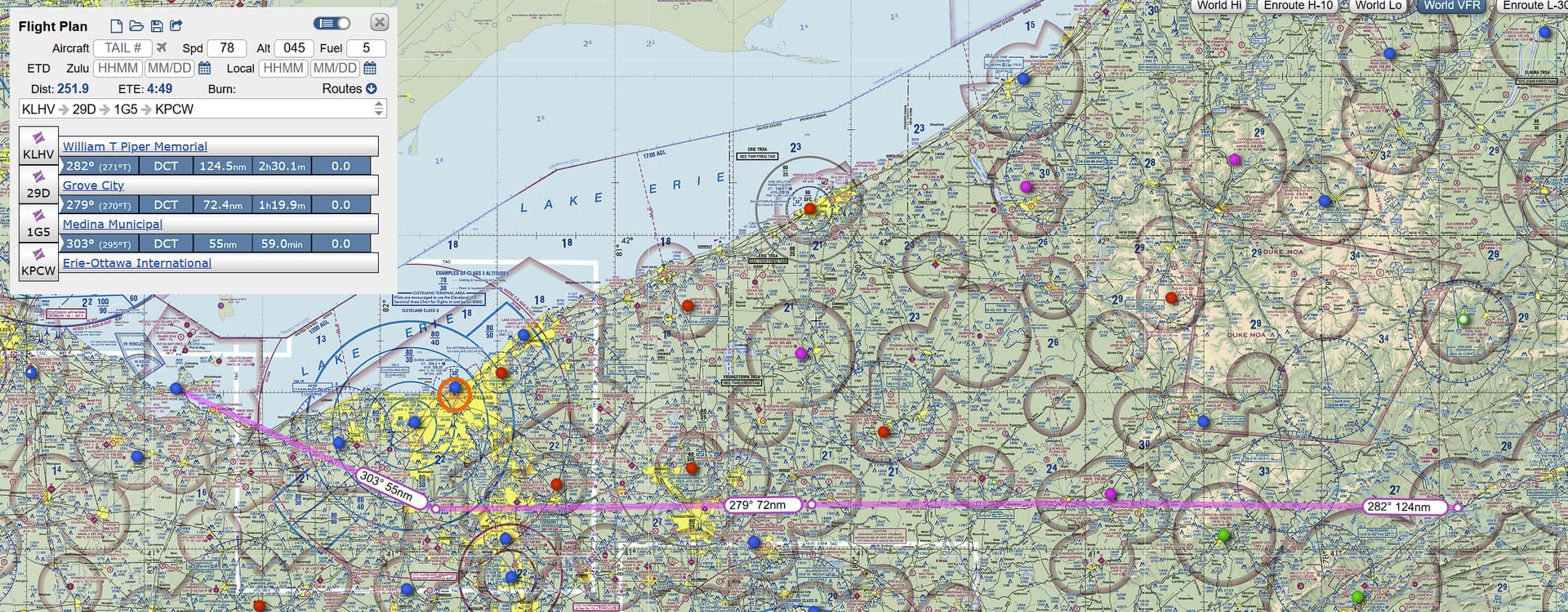

Currently planning straight west for fuel at 29D, then continue straight west again to fly over 1G5 then NW to KPCW. This route takes me over familiar area once I’m near YNG and allows me to split the CAK Class C and CLE Class B.
Have to figure out how to post foreflight or sky vector data…

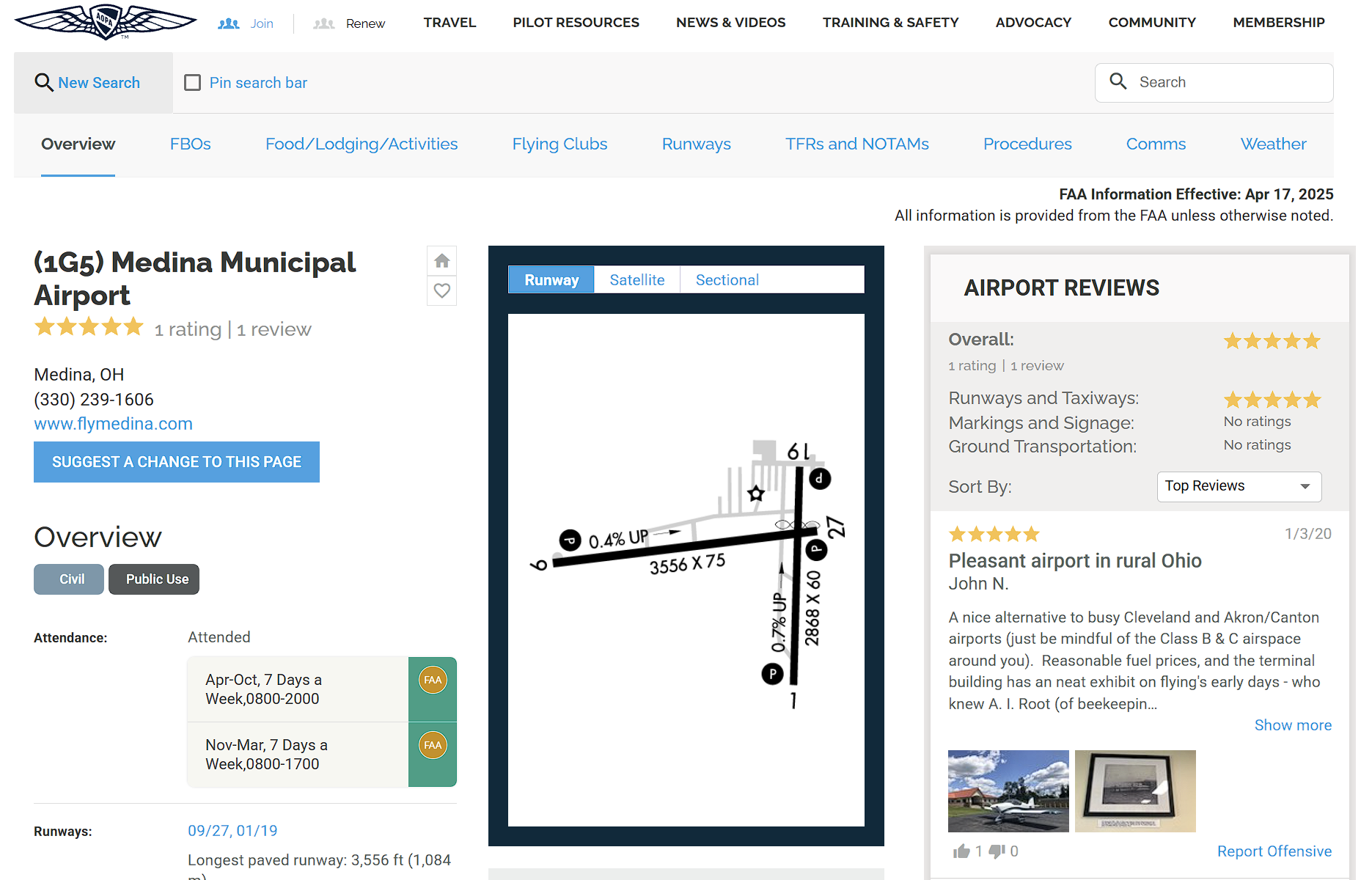

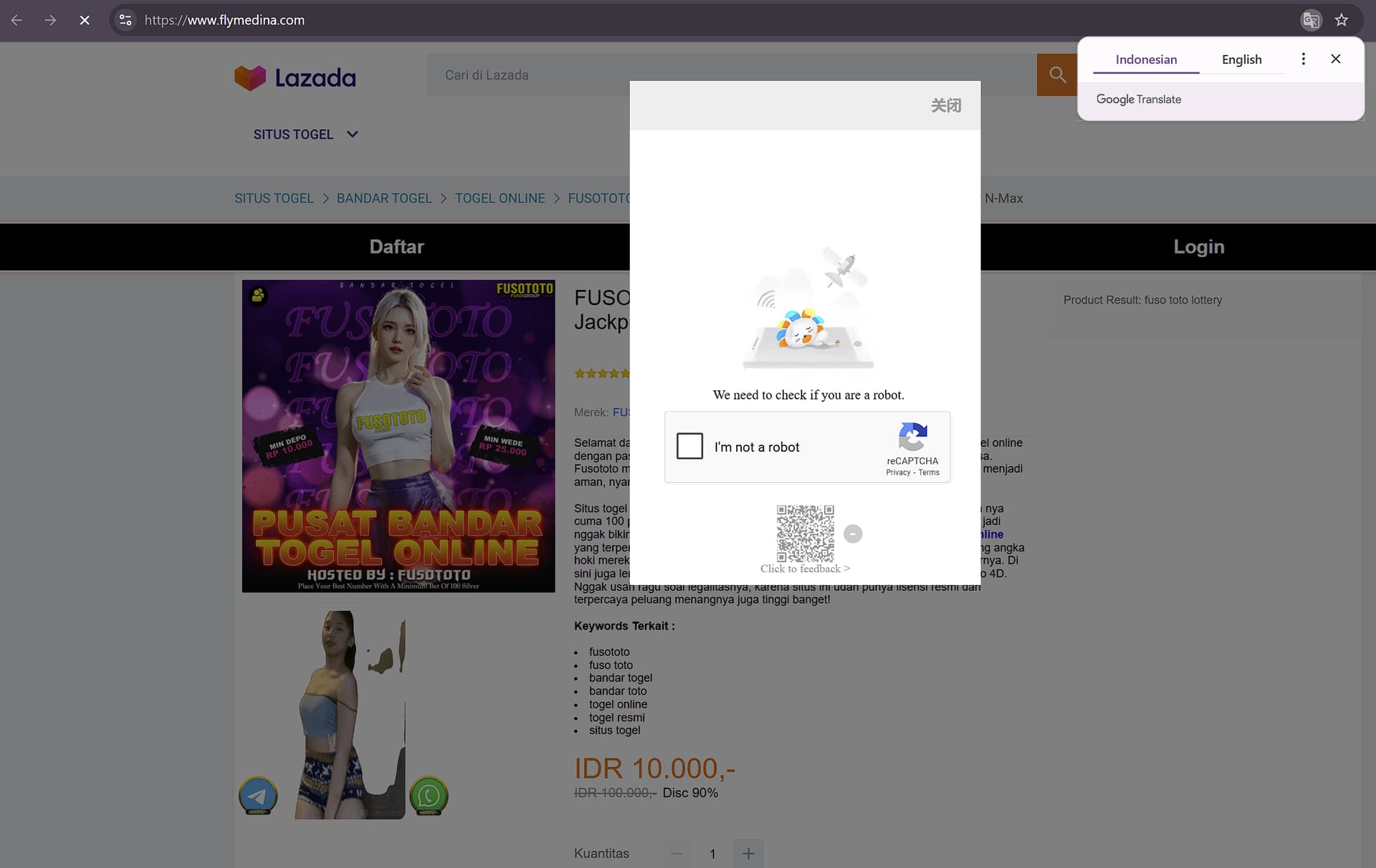

Based on it’s website, 1G5 (Medina Municipal Airport) seems wild.
It’s there official website according to AOPA.
29D is 2miles from being exactly equidistant so I don’t know how AXQ would help. As I see how fuel is burned, I may choose to stretch that first leg even farther. Thats a gametime decision.
AXQ being a “nicer” airport is almost a detriment to me. The weather is going to be nice so lots of people out and about and I don’t have a radio. All I can do is look out the window. Its threat mitigation. Does suck that fuel is more expensive
KLHV :right_arrow: 1G5 = 196.9NM
196.9NM / 2 = 98.45NM
KLHV :right_arrow: 29D = 124NM
124NM - 98.45NM = 25.55NM past the half way point
KLHV :right_arrow: KAXQ = 91.7NM
98.45NM - 91.7NM = 6.75NM before the half way point
I’m confused?
I’m not planning to stop at 1G5. It’s a landmark as guidance to split the CAK Class Charlie and the CLE Class Bravo.

So if you did it right now, winds would put you at about 2 1/2 hours ish each leg.
That gives you more reserves than I was initially thinking.

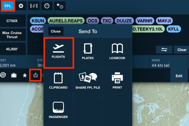

You going to have foreflight up on the new iPad for extra spatial orientation?
The link button on the upper right corner passes a lot of data on to the next person you’re sharing with which is great way to share routes. It’s definitely work registering with Skyvector to save these and other data for future uses like a lightweight foreflight.
Foreflight uses similar with the “Send to”
